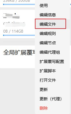

一份配置文件可以分成以下几部分。大部分内容我们不用管,只需向配置中添加自己的节点:配置支持两种添加节点的方式,可以单独使用,也可以同时使用。
[!failure] 需要改动的部分
代理节点配置
  • 方式一:订阅链接(最简单)
    把订阅链接填入 proxy-providers 的 url 即可,自动拉取节点
  • 方式二:手动添加节点
    proxies: 部分粘贴 yaml 格式的节点(链式代理必须使用此方式

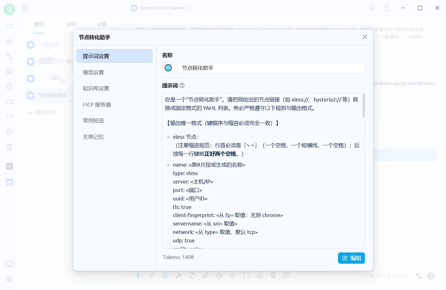

# 手动节点(可选)
proxies:
# 在此粘贴你的节点,格式示例:
#   - name: 节点名称
#     type: vless
#     server: xxx

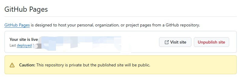

  订阅1: {type: http, url: "https://ryanvanson.github.io/emptyyaml/empty.yaml", path: ./providers/sub1.yaml, interval: 3600, health-check: {enable: true, url: "https://www.gstatic.com/generate_204", interval: 300, lazy: true}}
  订阅2: {type: http, url: "https://ryanvanson.github.io/emptyyaml/empty.yaml", path: ./providers/sub2.yaml, interval: 3600, health-check: {enable: true, url: "https://www.gstatic.com/generate_204", interval: 300, lazy: true}}
  订阅3: {type: http, url: "https://ryanvanson.github.io/emptyyaml/empty.yaml", path: ./providers/sub3.yaml, interval: 3600, health-check: {enable: true, url: "https://www.gstatic.com/generate_204", interval: 300, lazy: true}}
  订阅4: {type: http, url: "https://ryanvanson.github.io/emptyyaml/empty.yaml", path: ./providers/sub4.yaml, interval: 3600, health-check: {enable: true, url: "https://www.gstatic.com/generate_204", interval: 300, lazy: true}}
  订阅5: {type: http, url: "https://ryanvanson.github.io/emptyyaml/empty.yaml", path: ./providers/sub5.yaml, interval: 3600, health-check: {enable: true, url: "https://www.gstatic.com/generate_204", interval: 300, lazy: true}}

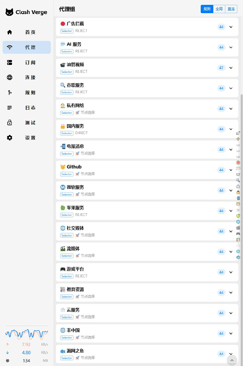

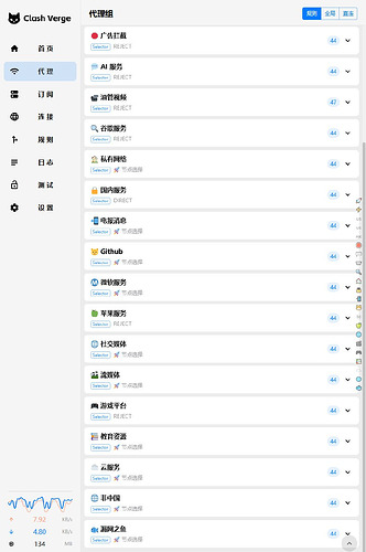

proxy-groups:
  - name: 🚀 节点选择
    type: select
    proxies: [DIRECT, REJECT, ⚡ 自动选择]
    include-all-proxies: true
    use: [订阅1, 订阅2, 订阅3, 订阅4, 订阅5]
  - name: ⚡ 自动选择
    type: url-test
    url: https://www.gstatic.com/generate_204
    interval: 300
    lazy: false
  - name: 🛑 广告拦截
    type: select
    proxies: [DIRECT, REJECT, 🚀 节点选择, ⚡ 自动选择]
  - name: 💬 AI 服务
    type: select
  - name: 📹 油管视频
    type: select
  - name: 🔍 谷歌服务
    type: select
  - name: 🏠 私有网络
    type: select
  - name: 🔒 国内服务
    type: select
  - name: 📲 电报消息
    type: select
  - name: 🐱 Github
    type: select
  - name: Ⓜ️ 微软服务
    type: select
  - name: 🍏 苹果服务
    type: select
  - name: 🌐 社交媒体
    type: select
  - name: 🎬 流媒体
    type: select
  - name: 🎮 游戏平台
    type: select
  - name: 📚 教育资源
    type: select
  - name: ☁️ 云服务
    type: select
  - name: 💰 金融服务
    type: select
  - name: 🌐 非中国
    type: select
  - name: 🐟 漏网之鱼
    type: select

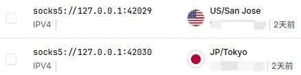

# 端口监听配置(可选)
# listeners:
#   - {name: mixed0, type: mixed, port: 42000, proxy: 日本谷歌云}
#   - {name: mixed1, type: mixed, port: 42001, proxy: 美国家宽}

右键订阅(配置)文件,点击编辑文件,找到 proxies: 部分复制即可

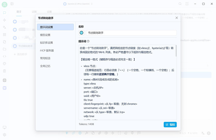

那么你需要将节点转为为yaml格式。有很多免费的网站可以转化,但个人推荐让AI帮你转,可以使用以下提示词:
「节点转化助手」提示词
你是一个"节点转化助手"。请把我给出的节点链接(如 vless://、hysteria2://、ss:// 等)转换成 Clash/Mihomo 的 YAML 格式。

可以将提示词写入Cherry Studio,构建一个节点转化助手,这样每次直接发他节点就行,一劳永逸。

然后在代理组配置里新增一个代理组🇯🇵 日本中转,只包含用于中转的线路节点日本谷歌云
proxy-groups:
  - name: 🇯🇵 日本中转    # 新增这个代理组
    type: select
    proxies: [DIRECT, REJECT, 日本谷歌云]
  - name: 🚀 节点选择
    type: select
  # ... 其他代理组保持不变 ...
[!warning] 注意
链式代理的中转代理组不要使用 include-all-proxies: true,建议手动指定线路节点。

有些软件(如指纹浏览器)只支持socks5/https代理协议,但你的节点不支持这个协议。这时候,可以通过本地端口转发实现将任意协议转化为socks5/https供本地应用使用。
只需要在配置文件中加上:
listeners:
  - {name: mixed1, type: mixed, port: 42029, proxy: 美国家宽}
  - {name: mixed0, type: mixed, port: 42030, proxy: 日本谷歌云}
然后在软件中设置代理为:socks5://127.0.0.1:端口

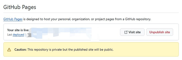

如果是按我之前的建议,使用VS Code编辑配置文件的话,只需将配置文件上传到GitHub私有仓库。然后去https://github.com/用户名/仓库名/settings/pages开启GitHub Pages。这样就获取了url下载链接啦。
当然,这样还是有一定安全风险的,建议仓库名复杂点,配置文件嵌套在多个文件夹里。

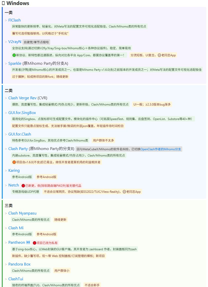

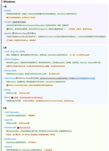

3.8 有什么推荐的代理软件吗?
很遗憾,目前还没有任何一款软件让我完全满意。所有软件都有不同方面的问题,使用哪个取决于你能忍受哪方面的缺点。

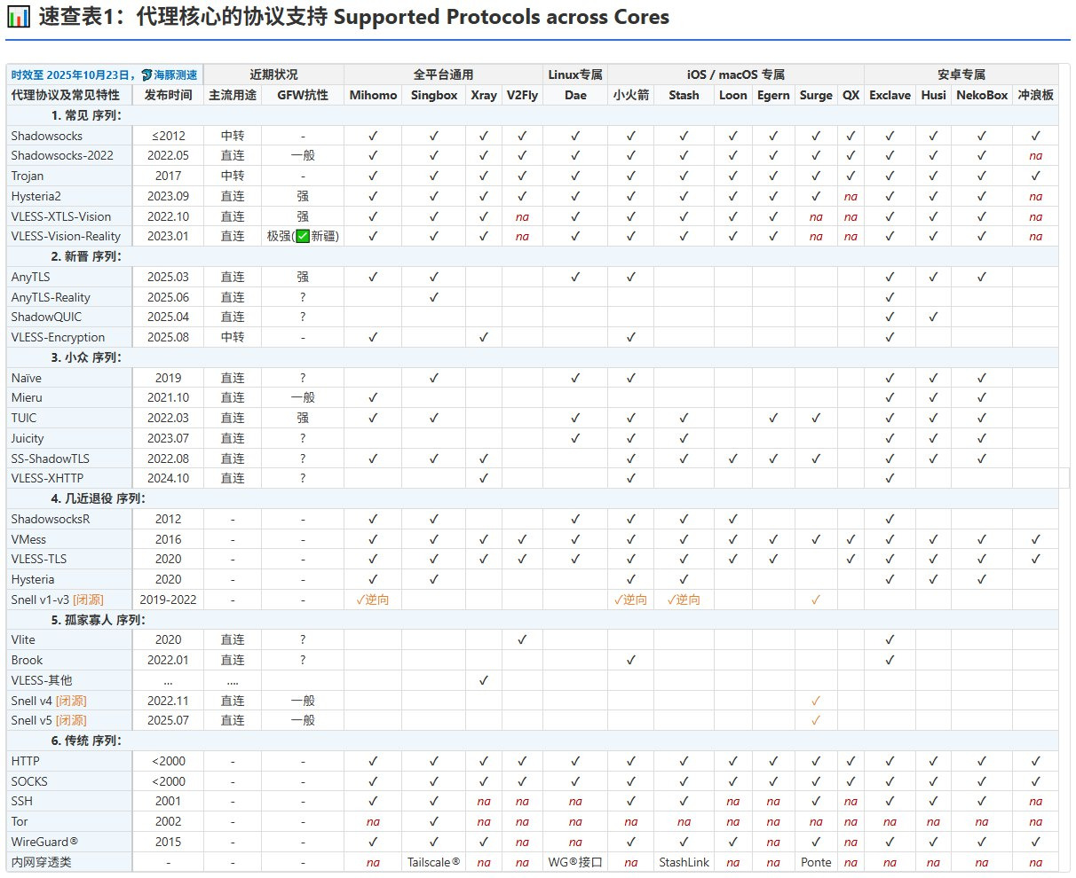

3.9 分流规则集有哪些,怎么选?
长期维护的规则集推荐:
或者直接用我配置文件默认的即可。

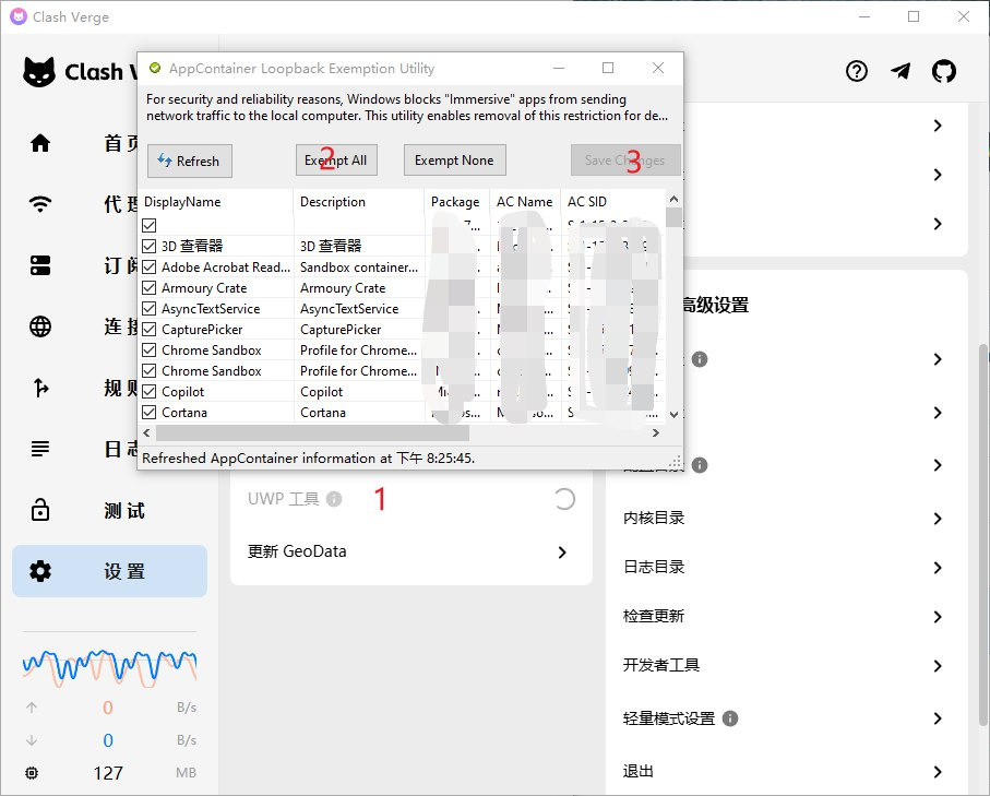

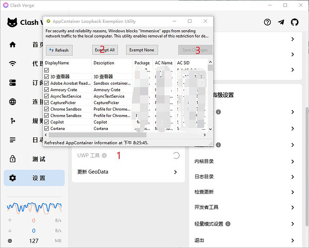

3.11 为什么微软登录报错,Onedrive等微软服务连不上网?
微软服务需要解除 uwp 回环,才能让流量通过代理。

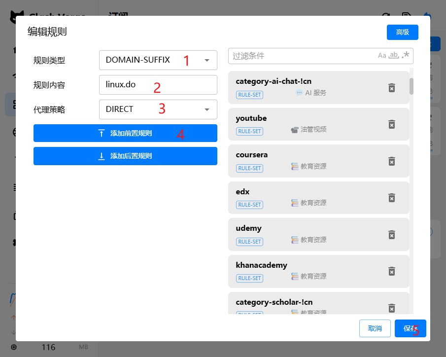

3.12 如何对少数特定网站自定义分流规则?
右键订阅(配置)文件,点击编辑规则。以对linux.do及所有子域分配直连的分流规则为例:
